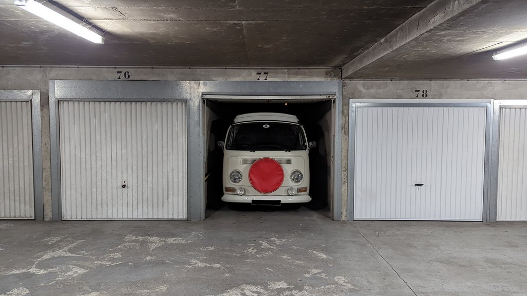

So I have a 1968 westfalia that I bought early last week. Not quite stock but I like it. I got it like on the first picture, and since then I've already switched back to the original mirrors ( picture 2 )
I've done about 1000km since I got it (what a week ! ) and I thought I'd post my joy but... It doesn't start anymore ! I was at a red light (on a slope) and while accelerating it stalled: no way to start again since. I thought it was running out of petrol but it hasn't started since I put it back in.
