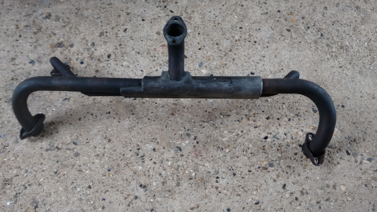

Just wondering if there's any interest in this.
It's off a June 1970 bus, stock single-port Solex manifold with no vacuum take-off.
Until I replaced it recently, I was running with a blanking plate in each of the heat riser flanges because the pre-heat pipe is rusted through in the sections where it sits below the intake pipe (see pic below). Due to years of collecting moisture I guess. Probably both sides of the centre section.
Anyway, I don't know if it's useful or repairable; I don't have welding equipment or skills needed. I considered just rust-treating it and clagging the gap with exhaust paste but there must be a better way.
I wanted a vacuum spigot to add a servo, so I replaced it and this one is spare / scrap.
Free to anyone interested and who will cover the postage (I have no estimate for that)
Cheers,
Rob
