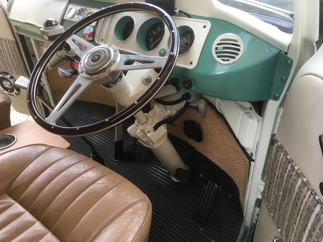

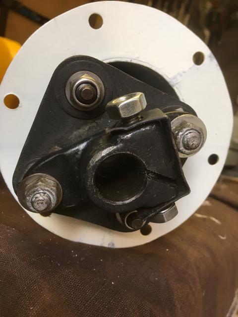

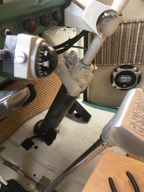

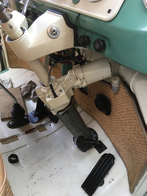

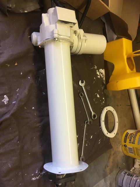

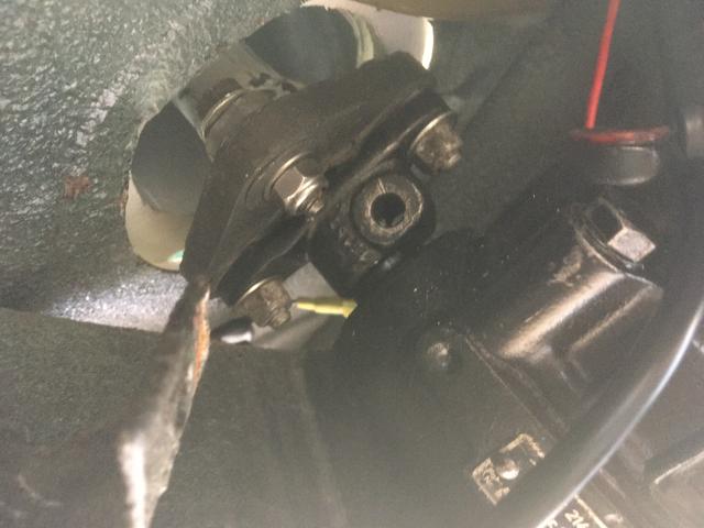

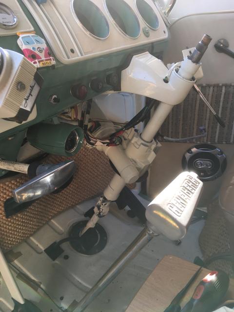

Vinvan & I recently fitted Power Steering to our Bus. Wow! Really glad we did it. We bought the unit second hand on here a while ago and only recently got round to fitting it. We think it is an easysteer unit but not sure. Vinvan saw how Litesteer brace the unit by enclosing the knuckle joint in a tube which also makes it look "less industrial". So we copied it :msn4: . See pics. It's more of a pleasure to drive than before! Especially as we have low profiles on the front. The force can be adjusted using the small dial knob which can be seen under the light switch in the next to last picture.

Hi, I wondered how good they were. I fitted one on my 69. Mine was off a guy off eBay for a fraction of the price but does require DIY skills and a welder. It’s great to drive now. Have you any pictures of your install? Happy campering!

Hi again! I’ve just seen the pictures. This isn’t a litesteer, it’s the same eBay one I have. The motor is off a Vauxhall corsa. I like the outer casing you made!
